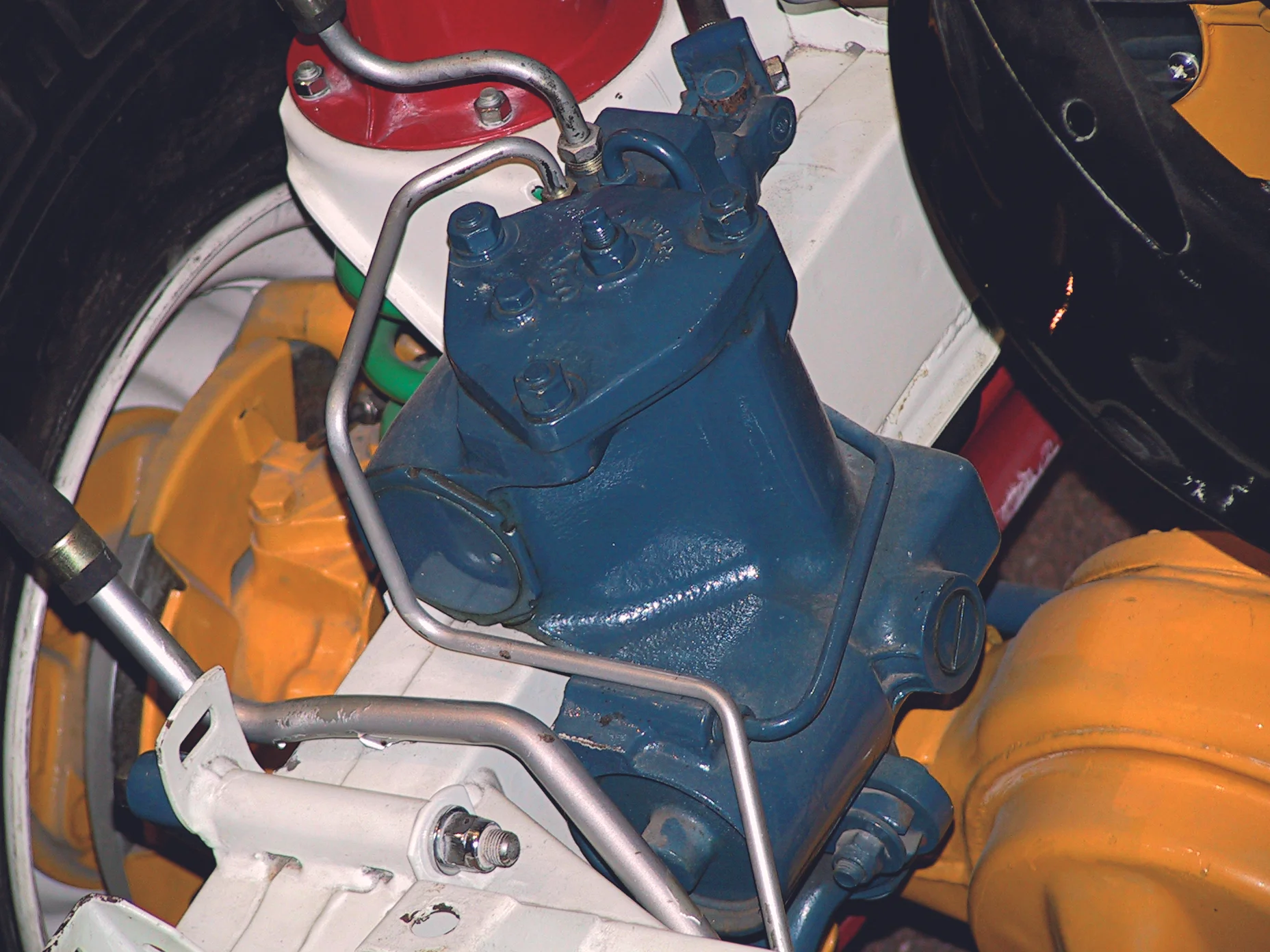

This is an easy job that needs only bolt- on modifications – so you could convert back to original at any point.
There were various power steering systems so it would be difficult to suggest a complete set of part numbers. The simplest way to get the kit is to buy a complete used one and use the steering box as an exchange for a reconditioned one.
The main parts you need are: steering box with drop arm, fluid reservoir with bracket, hoses, crankshaft pulley, pump with bracket and a belt, and a few other small ancillary parts.
