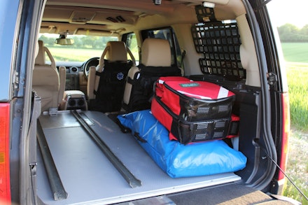

‘We’ve all heard horror stories about D3s so I wanted to de-risk the ambulance by fitting coil suspension,' he said. He also upgraded the oil pump and fitted a new timing belt – a common weakness of TDV6 engines. ‘Most of the corporate sponsorship came from businesses I was already a customer of.’
Room for two medics, driver, one stretcher, plus driver and equipment.
A group effort
The Discovery 3 ambulance is equipped to carry up to two medics, in addition to the driver, plus one stretcher.
Goods and services worth around £3k were provided by Arkleys 4x4 (which carried out the work on the engine). Other support came from Advanced Factors (which donated the uprated oil pump and service items), Terrafirma (spring conversion), Major Mods (the vinyl wrap), Medtree (medical kits and a defibrillator) and Land Rover Passion (which provided panels for attaching medical kit, and an interior tailgate release cable).
